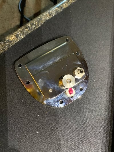

Do you know if these will fit my Fender trem? I brought a 5mm bolt home from work today and it doesn’t fit in the hole. It’s close, but it won’t drop in.
View attachment 281521View attachment 281522
That one with the red loktite dot on the underside is the Fender AV/AVRI unit. An import 5mm arm won’t work for that one, you need the AVRI bar that has a little notched section in the end.
The MIM/MIJ Fender & Squier arms are 5mm import arms that just have a plain smooth tip. The AVRI one is the only one with this notched area on the tip.

Thank you! So I have an arm coming that won’t fit but on the bright side, I have the better of the two trem units! I guess that’s a win in the end.
dbrian66
Jul 14, 2017
13,166
I posted this in the thread on my Jazzmaster, but it’s good info for this thread as well.
I have a tremolo on my CV Jazzmaster that has been replaced. It has the Fender logo on the face of it and and a dab of red Loctite on the underside of the lock button. Thank you to @ericb7799 for providing the info that identifies this as a Fender AVRI tremolo.

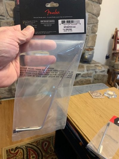

The trem arm that fits this tremolo is this one.

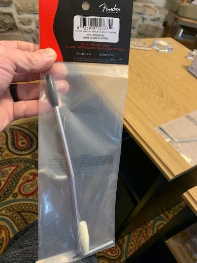

The trem arm I originally ordered, I guess fits Squier and MIM Jazzmasters. It has a smooth end and measures 5mm. Here is that part.
