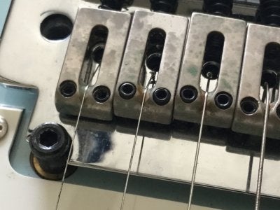

Had some rust and corrosion one the bridge and fret or two. Did some research and found that bartenders friend and dry lube or steel wool #0000 was suggested. Is that the way to go? The rust is in the groove of the saddle. It looks worse than the second pic shows.
Thanks in advance

I’d probably use the 0000 steel wool on the frets that need it (put tape over the pickups to keep the steel wool dust off them) and use a good quality gun oil or similar and a toothbrush to see if the saddles will come clean.

I'm one that believes that steel wool has no place on a guitar..I've used it and found it to be more of a problem than a help..
For the saddles, I'd remove them and soak them in cleansing vinegar..
I'm sure there are other products that will work as well..
The frets will clean up by dressing them down with sand paper..

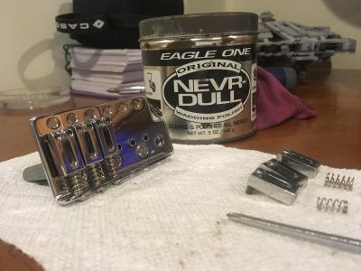

I agree. The steel wool will clean it up, but there are other things that work just as good, if not better, and don’t have the negative effects. I like to use Nevr-dull.
This stuff works great and it’s really easy. Here are a couple before and after pics of a bridge I cleaned up.
And frets, I like to use sand paper. Progressive grits of 600, 1500, 2500, and then automotive rubbing compound. They will shine bright and be smooth as a baby’s bottom.
Nevr Dull works great, been using it for years.

Thanks all for the direction. Turns out I had a few of the items discussed. Took off the strings and bridge/saddles.
For the bridge the magic eraser worked. That thing shines now.
On the neck I used gorgomyte. I had one on hand. I suspect the rust was not that serious. Again now the neck looks great.
For the saddles the magic eraser could now touch the crud so thought I would get some never dull.
