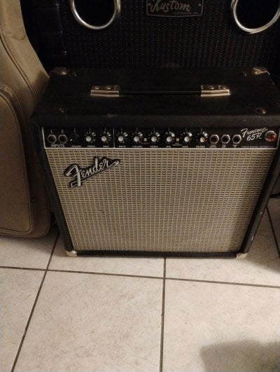

The volume pot on my fender China built, is not functioning on my 65R I'm in need of one to resolder on the PCP board as the one on there now is on 10 and will not let me adjust the volume in the clean channel. The amp sounds really good in the clean channel, and drive channel is good too, it did come with a good fender yellow and brown label speaker, got it at GC for 53 dollars,
Thanks all.
