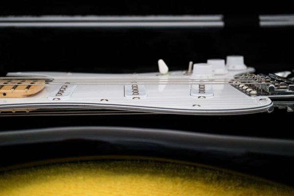

Me, I like them lower. I dig the clarity and the sustain I get from lowered pickups, I just get more of the tones I really like. With any guitar I obtain, I'll start with where the pickups came height wise. I'll tweak higher then I'll tweak downward; it just happens to sound better as I lower those pickups. I start from the neck pickup first, then balance going towards the bridge.
There is no wrong or right height, but really, one should experiment and not simply rely on factory suggested settings. Pickups sounding too dark, drop 'em. Too thin, raise 'em. Want to tailor each string, raise or lower individual poles (if you can).

Here is where I have adjusted mine:
Fender Player Strat, stock pickups:

Bottom of fretted string to top of pole: Neck ( low E 4mm--high E 3mm ) Bridge ( low E 2.5mm--high E 2mm )
