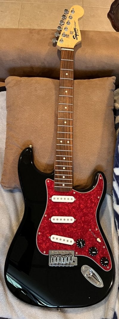

Can anyone ID the model of this Squier Strat with body that is 1 25/32” thick, a CXS 03 serial number, and Crafted in China? Is it an SE or something else? Anyone know
what the pups would be and the quality of them, or the rest of the guitar model? Keep the stock pups or replace with GM 62’z or premiums? Anyone know the routing shape under the hood? Thanks in advance.

At least the neck is an SE. The body probably is as well, but the pickguard has definitely been changed. So who knows what the pickups are. The stock pickups are ok. Nothing great, but usable. I personally replace everything on these guitars. But that’s more because I want to rather than I need to. I would suggest setting it up real good and just play it. You might just love it as is.
Here is what the pickup route looks like.

Well, 25/32 is .78 in decimals meaning that'd be a full sized body. It's an SE. FWIW, those 62z are every bit as good as the big money big names.
Thanks. Might install a high mass block, roller ferrules, and the 62’z. Depending on what I find under the hood, maybe some new electronics, shielding, and a treble bleed.

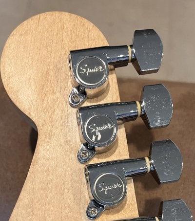

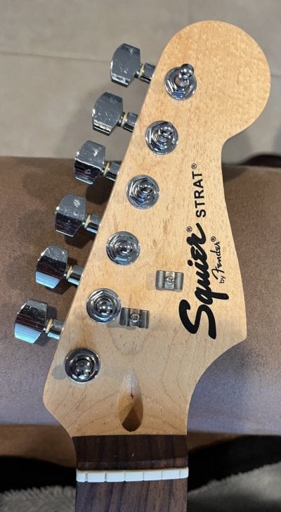

@dbrian66 @Protone @Texaspicker @Nduro @Wikingcaster @Guitarmageddon
I plan to mod this SE and need some thoughts on options:
1) high mass MIM block or GFS high mass brass block (I have them already - just need to pick one - any thoughts? Shown in picks.
2) are these stock tuners any good or should I replace? If so, with what?
3) should I install a TUSQ XL nut or leave stock?
4) replacing electronics with GM 62’z and a GFS premium strat harness;
5) installing roller guides;
6) filing fret ends to smooth neck sides;
7) installing shielding;
8) full set up and D’Addario Nickel Wound 46-10’s;
Thanks in advance for your recommendations.
dbrian66
Jul 14, 2017
10,555
I personally prefer the brass block. But that’s opinion based and I’m sure someone else will tell you something different. The good news is you already have both, so you can try both and see which one you prefer. Another mod I always do it the Tusq nut. Just make sure you get one with the proper dimensions. I also like to use the Tusq string trees. Stock tuners are fine unless you are changing them for cosmetic reasons. An on/off switch for the neck pickup is also a great (and easy!) mod to do while you are changing out all the electronics.

A question for you Mr Oldguitarguy, is that tusk nut definitely the right one. I ask because I have a 06 cxs and would think it would be the same. I noticed when restringing after upgrading all the guts (62z, mim players pots and switch) that my nut is loose in the slot and moves alot. I figure if I gotta pop it out to reglue, I might just upgrade it as well.
